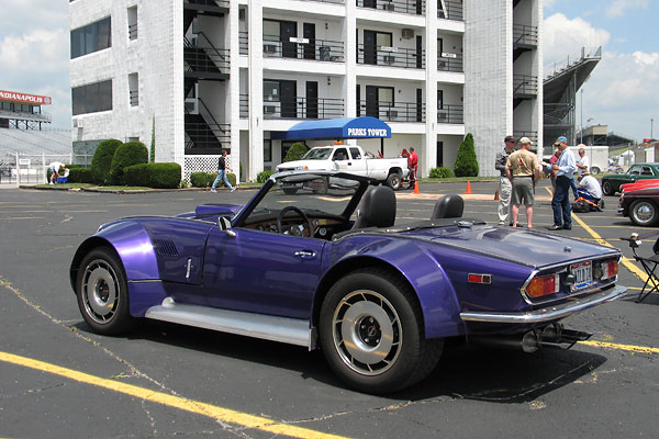

This guy grafted his Spitfire to a Corvette roller skate. If this can happen, anything must be possible.

nderwater wrote: This guy grafted his Spitfire to a Corvette roller skate. If this can happen, anything must be possible.
With flares all things are possible
