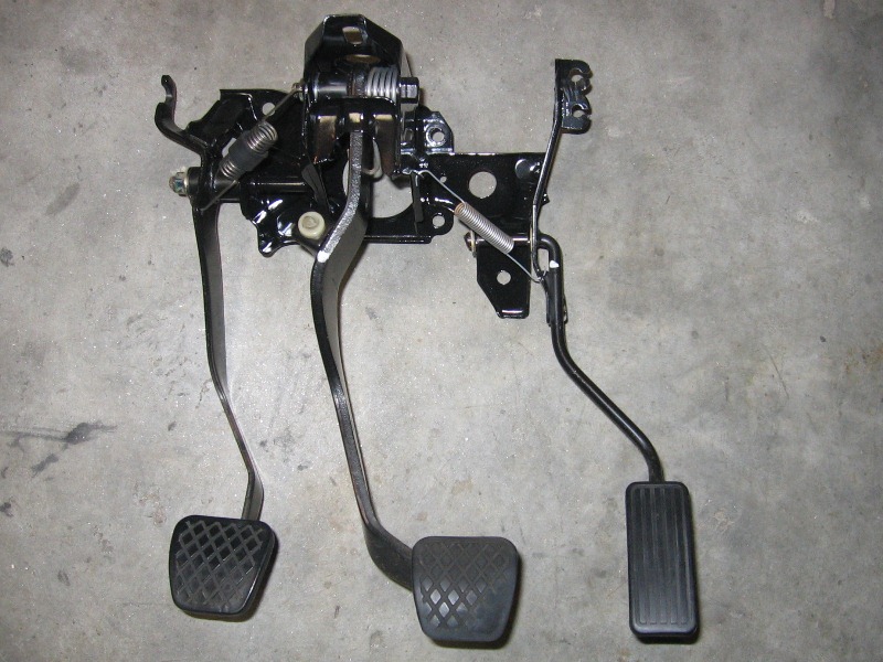

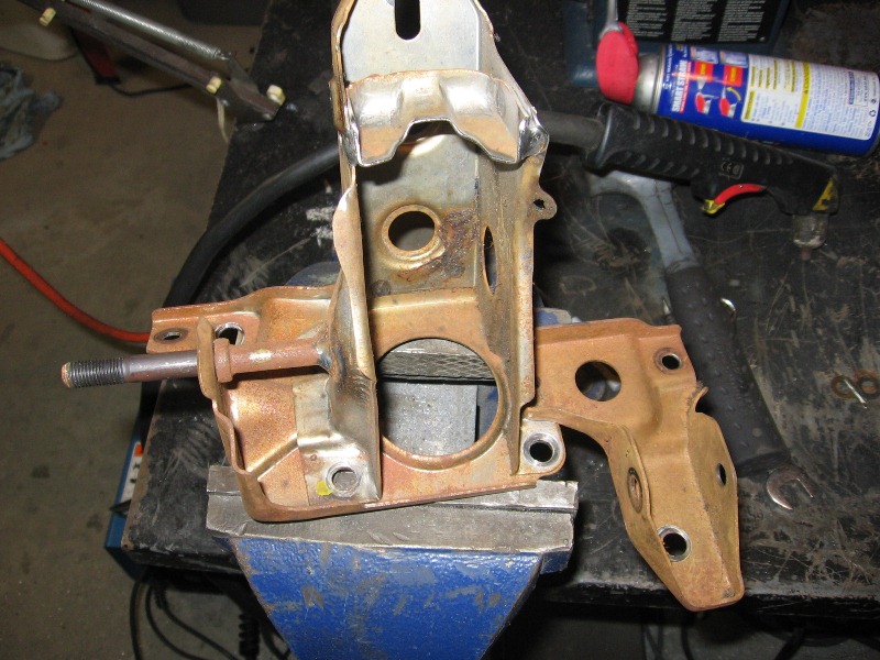

You're not the only one -
Before:
After:
Before:
After:
BTW - I've become a huge fan of the Rustoleum Professional line for restoration stuff like this. Lays down really nice, and is tough when it dries.

DILYSI Dave wrote: After:
I actually recognize those. I had a set of them too.

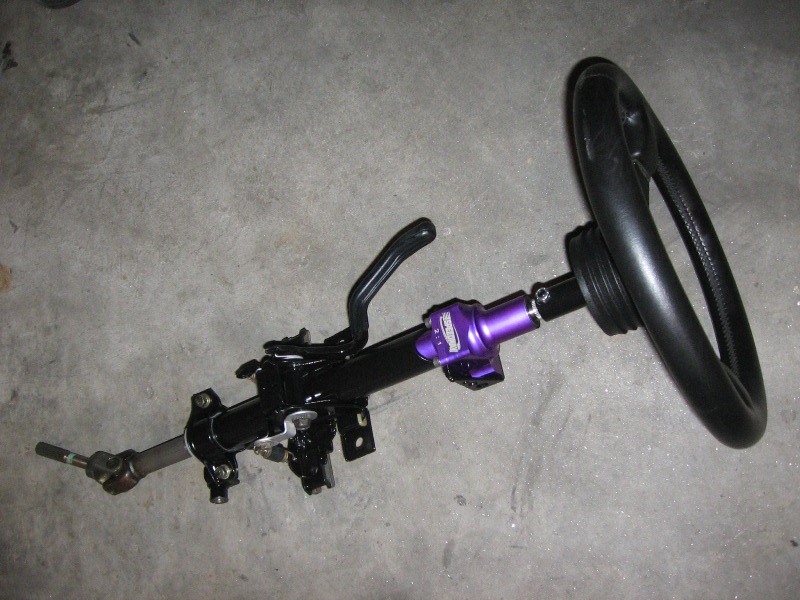

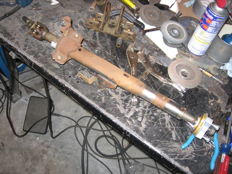

Nice work! How much work was it to put the steering quickener on there (ie. did the splines match, or was there some fab work involved)?
Also - one small note - I have seen the older 911 plastic bushings on the pedals jam - on one occasion they jammed the gas pedal at WOT. i know you are flipping this one, just something to consider.
DILYSI Dave
DILYSI Dave SuperDork
3/10/12 2:08 p.m.
fifty wrote: <blockquoteAfter: Nice work! How much work was it to put the steering quickener on there (ie. did the splines match, or was there some fab work involved)?
Thanks. Lots of fab involved. It somewhat complicated it by insisting on retaining the tilt mechanism, but the finished product was worth it.

i have been trying to put a steering quickner on my 90 vett but had not been able to find room till now . never thought of the top thanks
