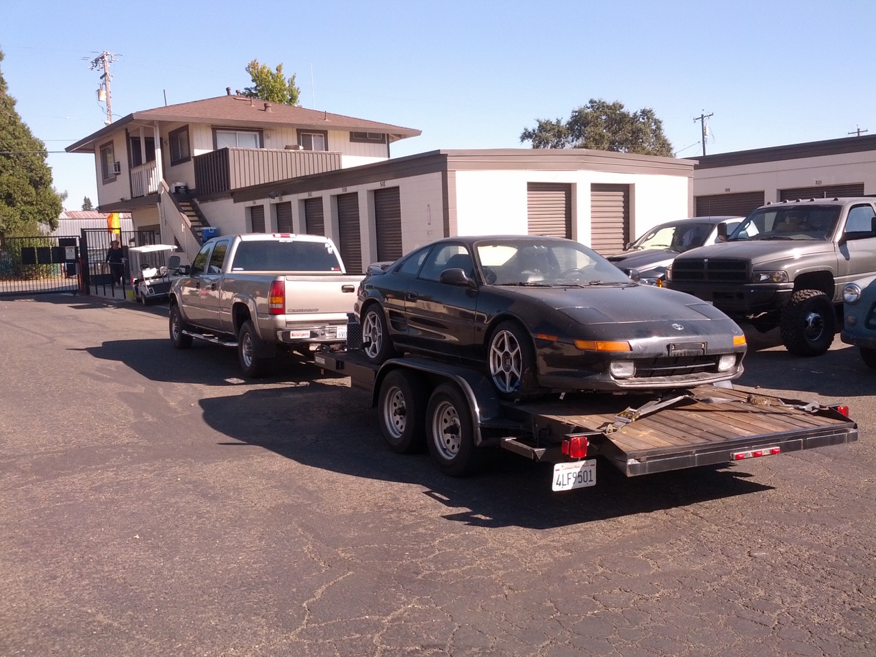

An interesting thing on the car loaded backwards bit: depending on the length of the trailer vs the car and the trailer's axle placement, loading backwards is actually better in some cases.  Just move the car further forward on the trailer when you do it.  If stuff is positioned well, you end up with similar tongue weight but with less weight behind the trailer axles (ideally the heavy axle of the car should be pretty much right over the trailer axles or at least not behind the rear trailer axle).
Given the ability to design my own car hauler, I'd push the axles back further than most and plan to load backwards.  It'll be more stable in the end but without the excessive tongue weight that loading forwards would give with the axles pushed back.
Like this one? :)

I had the Esprit loaded on backwards for the trip from the PRC to Free America.  Perfect tongue weight that way.  Europas are shorter, so they can go on facing forward.  Plus they weigh half as much as an Esprit.

We had to turn the 500ci-powered Fiero around backwards on the trailer because the weight from the rear engine was causing massive sway.  I'm guessing that's a pretty good option for most rear-engined cars.
