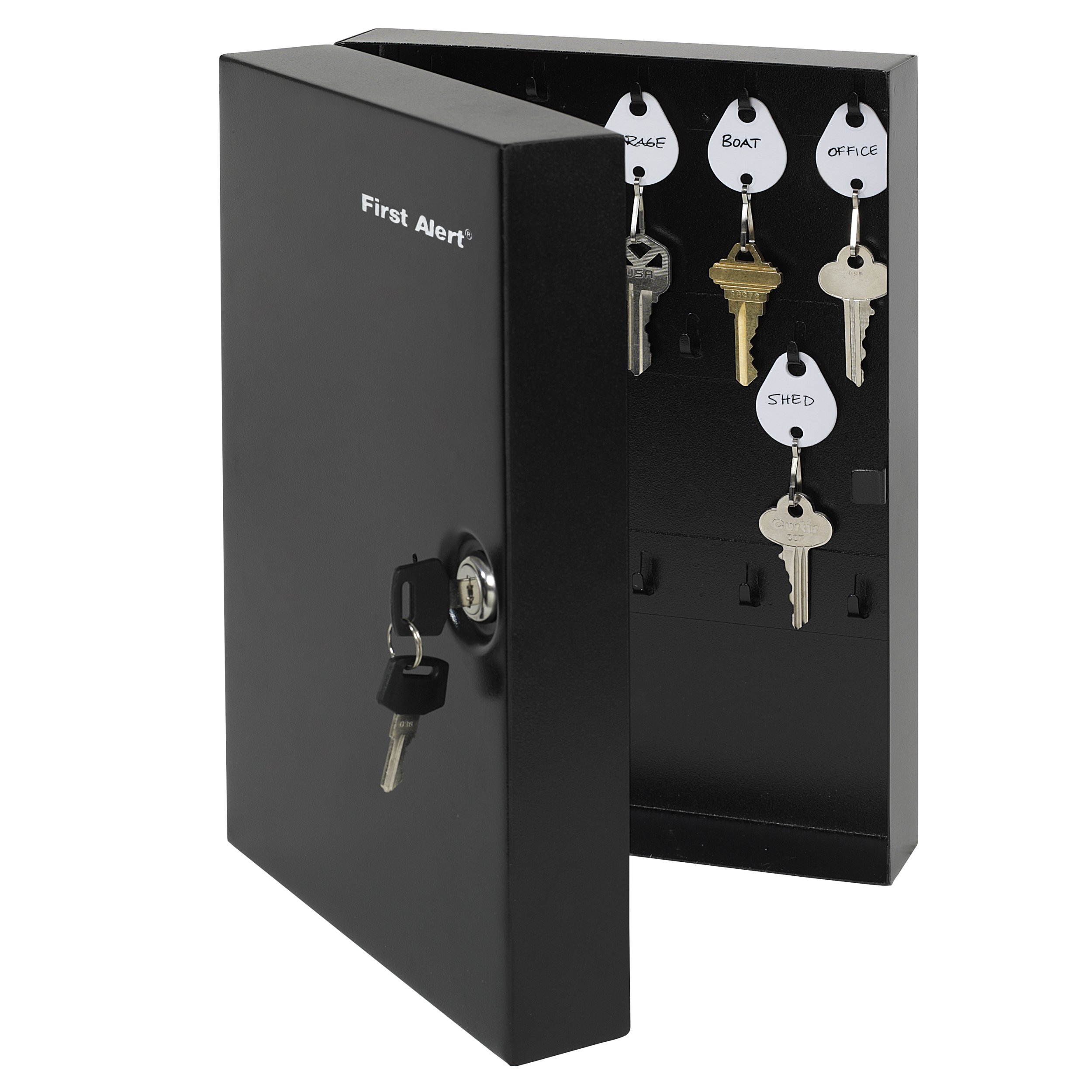

Control the keys, assign somebody to check all are accounted for at the end of the day.
