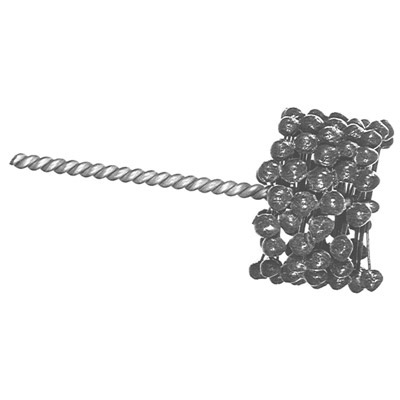

Nice find! If you are thinking to Scotchbrite the cylinder bore, I'd advise against it. Scotchbrite is pretty aggressive. Borrow a flex hone:
and run it through just enough to get the glaze off. If it's going to be a while before you put the cylinder back on, smear grease on the inside of the bore with a rag to prevent rust.
IIRC on those you have to split the cases to get to the left side crank seal, so even if it looks okay it's a good idea to replace it.

In reply to Curmudgeon:
Thanks for the tip, I will search for a hone today. The cases will be split when I find my snap ring pliers. I have a complete set of gaskets and seals that I will be replacing.
