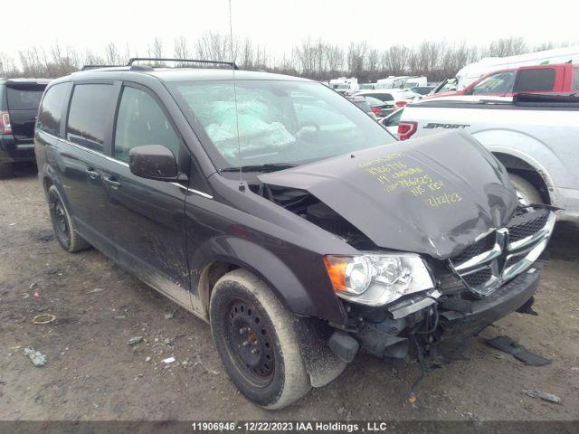

2019 Caravan. Not branded, 40k (miles). $13k in your money
I'm getting frustrated trying to buy a van. This is lower mileage and newer by a lot than I can get for this money right now.
Look or run?

That's a pretty hard hit. I'd be afraid of it. For sure the airbags were deployed, and I wouldn't be surprised if they were replaced with some wadded up newspaper.

I disagree with the Doc.  That doesn't look like a hard enough hit to have blown the bags.  But maybe I've been looking at too many of the IAAI listings to know any better.  Do you know / trust the seller/rebuilder?
An extensive inspection would be necessary, but personally I wouldn't be afraid of that one.
In reply to Indy - Guy :
You can see the passenger bag in the photo-

Well E36 M3.  I guess I was wrong.  If they were replaced properly and the computer reset, it shouldn't be a problem.   I'd wanna check to make sure the AC is functioning and not punctured.

The airbags were most likely the most expensive parts for this repair. It does not look like a bad hit. It was most likely totaled because of the value of the van vs the cost of the repair (70-80% of value).  Ask to see pictures of the repairs and have a scan done. It looks like a hood,bumper grille,headlights repair.

Rebuilt has been a hard no for me in the past, and that's probably not going to change, but I didn't think this one looked too bad, and thought I'd see what the experts think. The carfax called it a total loss and a $30k repair. The seller was totally upfront about it.

I'm surprised it doesn't have a rebuilt title if it's was declared a total write off by Carfax.   There should be a MTO certified inspection of the repairs done before it can be re-licensed in Ontario.
Check the MTO website for the various stages that have to followed to get from a salvage title to rebuilt status.

Only way to really know is to look closely at the frame rails. They can beca 1 and done in a modern car. They're designed to self destruct, to a degree. And the way they're built can be tough to replicate. If they're fine, the next concern is drivetrain. The trans probably hated that hit.
