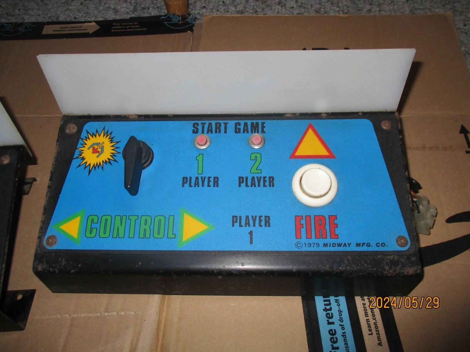

To convert to Galaga properly, I would need to get new control panel pods with the correct joystick controls. Galaxian controls look like this:
While Galaga controls look like this:
The chicken-head knob controls are weird but work. You flip the long part right to move left, and vice versa. It's intuitive once you get used to it, but it's not right for Galaga.
