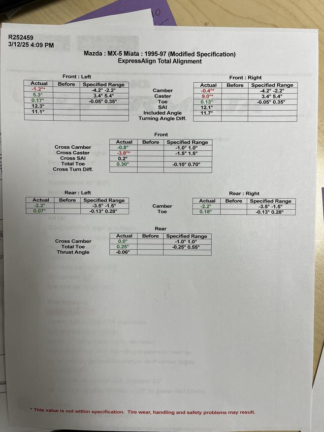

Alignment time:
I'll let Gariation chime in about the numbers.

3/13/25 10:45 a.m.
Here is the best we could get it. Something is going on in the right front. Maybe slightly tweaked control arm? It's passable and the car is stable but understeery in a quick parking lot loop.

3/13/25 7:53 p.m.
In reply to garaithon :
I have kinda the same understeery impression with the Molvo. I wonder if the ackerman being off by the 7" chassis stretch is the cause.
It is not a problem for the way I use the car, but wonder what the effect will be around the cones.
