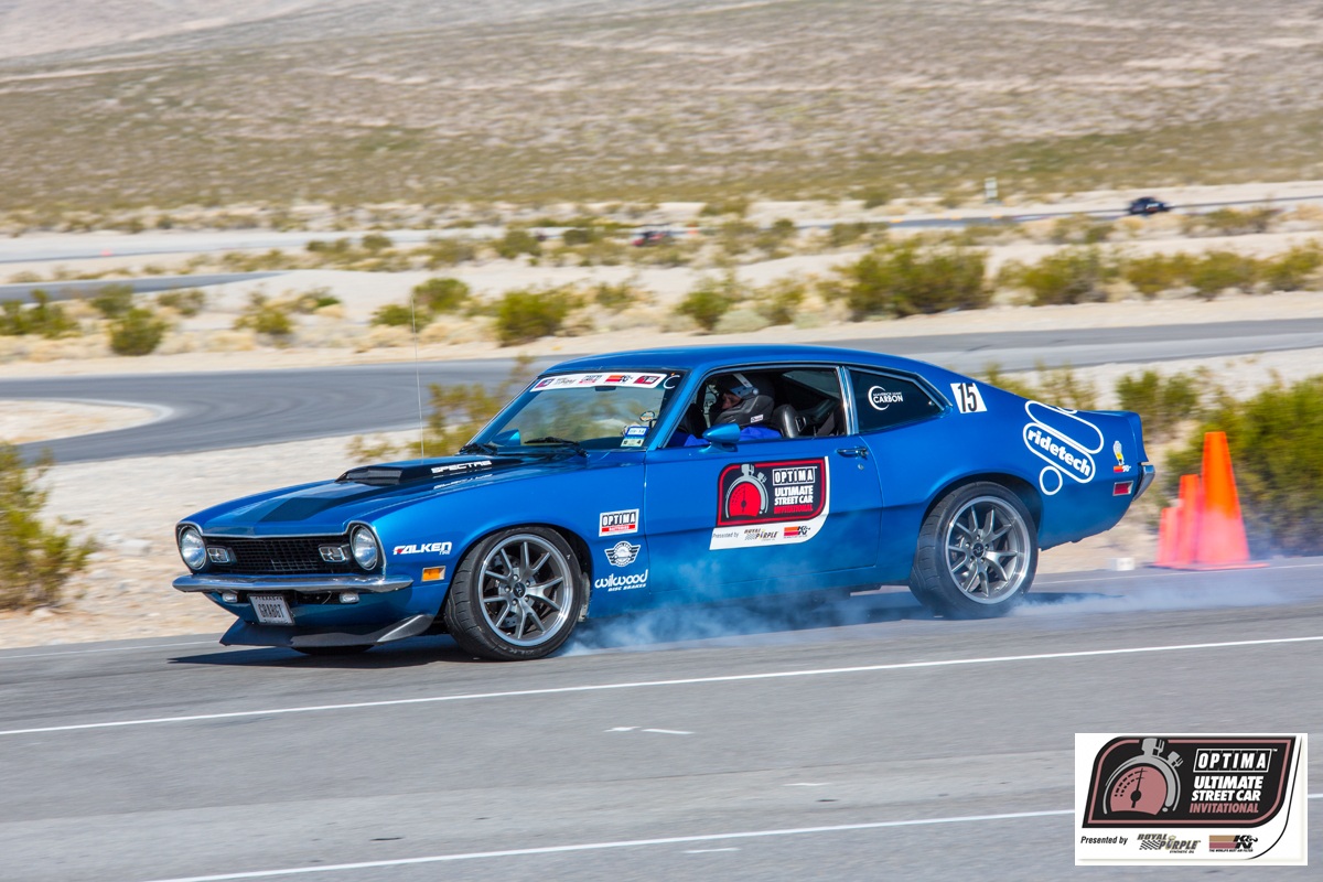

How about a 4 door Maverick.
Is it possible to then add a 300cid I6 and a 5 speed manual trans?
Or, final goal somewhere between here:
And here:

In reply to John Welsh :
Having owned a 4dr maverick, I am not sure it meets handling requirements. It was fun as hell to throw around and drift on what mustve been 135 wide tires, but I suspect it would start to drive weird on wide rubber. I recall the suspension being a bit wonky feeling at the limit. I suspect a track car would be more fabrication than ford. Miss that thing. Got it with 32k and original everything, watched my ex gf swap the headgasket, a few months before my next gf totalled it. Good times.

Yeah, you can do a lot with a Maverick to make it preform- but that's also the problem, they need plenty of aftermarket stuff. Plus, their opening for their radiator is small enough that it limits some people on engine choice.
