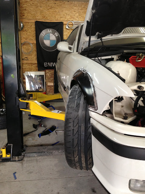

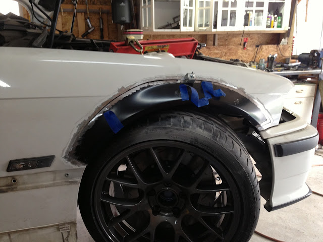

I want the flares to look stock so lots of measuring and planning before cutting.
I want to keep the edge where the bumper comes to so everything flows like it was stock.
Front flare at the edge where the bumper will meet. The new flare might get cut slightly higher but it's closer.
It will match up on the back side under the trim...or right at the top edge
The top of the new flare still needs to be smoothed out to a nice circle and then the e36 fender will get cut and start welding in the new one. The entire passenger side will get done..front and rear and then repeat on the drivers side.

More fitting...
Rear...
Somewhat setting on the ground...can't go all the way becasue the rear fenders are not cut out so they fit the tire.

The drivers side flares are mocked up to match the passenger side. Still a little bit of trimming and then they can get cut out and welded.
bumper and everything is just setting on and nothing is tightened up. I was trying to get a picture showing how the flares look from the front. Sorta hard to do...

Time to start cutting...
jakeb
jakeb Reader
6/11/13 3:49 p.m.
thanks!
More cutting...
Inner fender left and it will get bent to match the new flare
Fronts tacked...

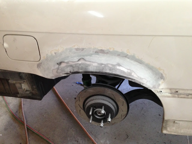

Lots of little tacks...I go around each flare. Let it cool for a bit and do it again. To keep any warpage to a minimum.
Fronts still need more

I left part of the inner fender and then will bend it out to match the new flare. Either weld or use panel adhesive to hold the two layers together.
Picture isn't very good as the flash on the camera went off and picked up all the dust, etc
All the welds around ground down

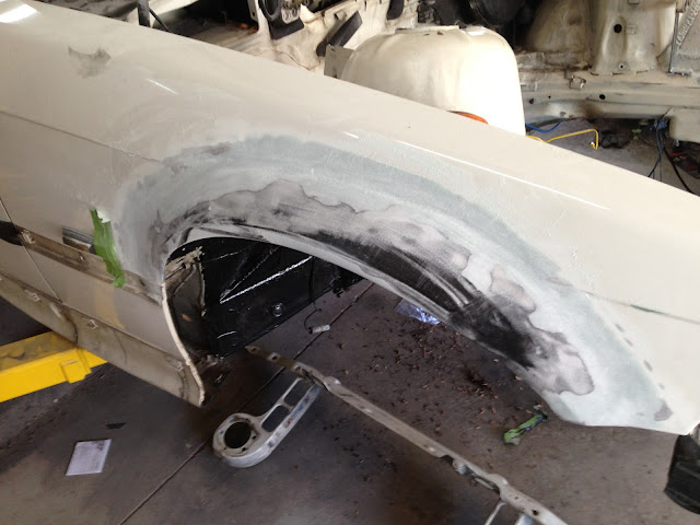

First coat of filler (duraglass) going on the flares

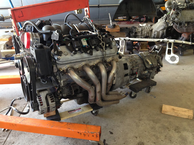

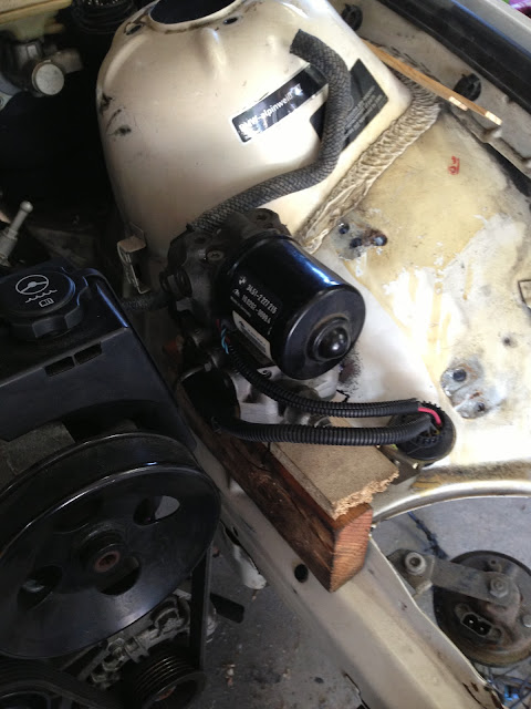

Engine is back out:

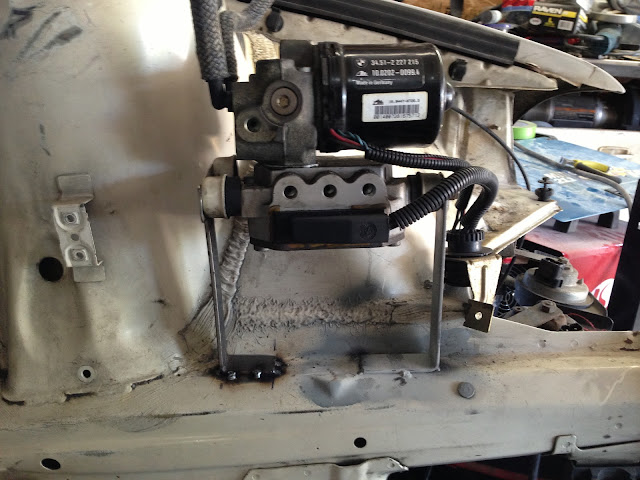

ABS pump location
ABS pump brackets
Engine bay getting ready for some fresh paint

More flare work

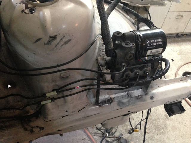

Brake lines to ABS pump all extended...and off to powder coat
