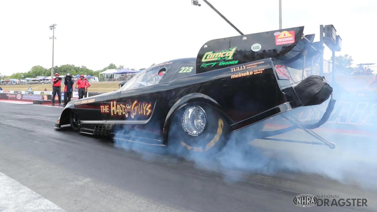

The short block was "donated" to me by an old parts store customer of mine when I was in college. It was in a 1970 Trans Am that was left outside (owner went to prison!) and the heads were missing. Rainwater had weather seized it, and it was already .030 over. Somehow, it cleaned up. I have pics somewhere, and it was ROUGH!
The heads came from my local junkyard. The junkyard owner had a 1971 GTO as a teenager that he swapped a 427 BBC into. The heads were all he had left of the car, and they were sitting in a storage trailer for decades until I came along. I paid $90 for them back around 2004.
Engine was built by Dana Hard at Camco Racing/Custom Automotive Machine in Weymouth MA between 2008-09. Dana's an old-school kind of guy, and mostly a Ford guy personally, but he digs old Pontiac stuff too. When I brought him the crusty block, he had to see if it would clean up. To our surprise, it DID clean up at max overbore of .060 over. Fun Fact: Dana's also a privateer NHRA Funny Car racer, and kinda crazy. I think this year he's handing the keys over to another driver, but he was pushing 80 and still driving this thing competitively up until now.
Building that engine was tons of fun, and quite the old-school experience. We sat and poured through paper catalogs and consulted my copy of "How To Build Max Performance Pontiac V8s" to try and eek the best out of the Ponti-Mutt, which is what I ended up calling it. The goal was 400HP and 9.3:1 compression, basically the higher end of what you could do on pump gas at the time and keep it streetable. I never got it on a dyno, but its got the right ingredients.
If I had to do all it again now, I'd probably build a stroker 6.6L LS engine. Easier to source parts, even more power, more streetability, and EFI for easier tuning/logging. Hell, that may happen someday anyway. And it would make the purists angry. wink
