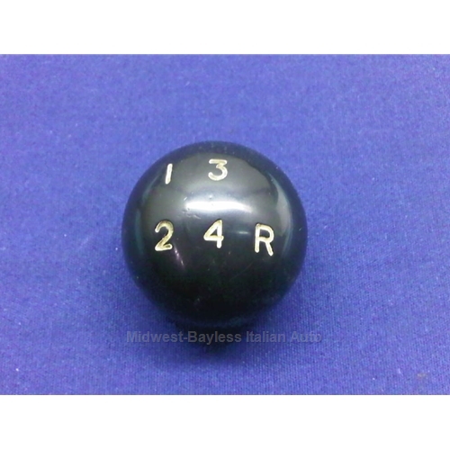

Oh yeah. I have a very strange fondness for old Fiat shift knobs. I think they are perfect.
But the 901 transaxle has a dogleg pattern. This won't be as easy as using a 124 spider 5 speed knob. But the other day I was doing a test drive and looked down at this beauty
Holy Frijoles! it's perfect. Happens to be in this BTW
"If you have the means, I highly recommend picking one up"
But it looks like repops for a 246/308/328 can be had for under $50 so I will deffo be nabbing one.
