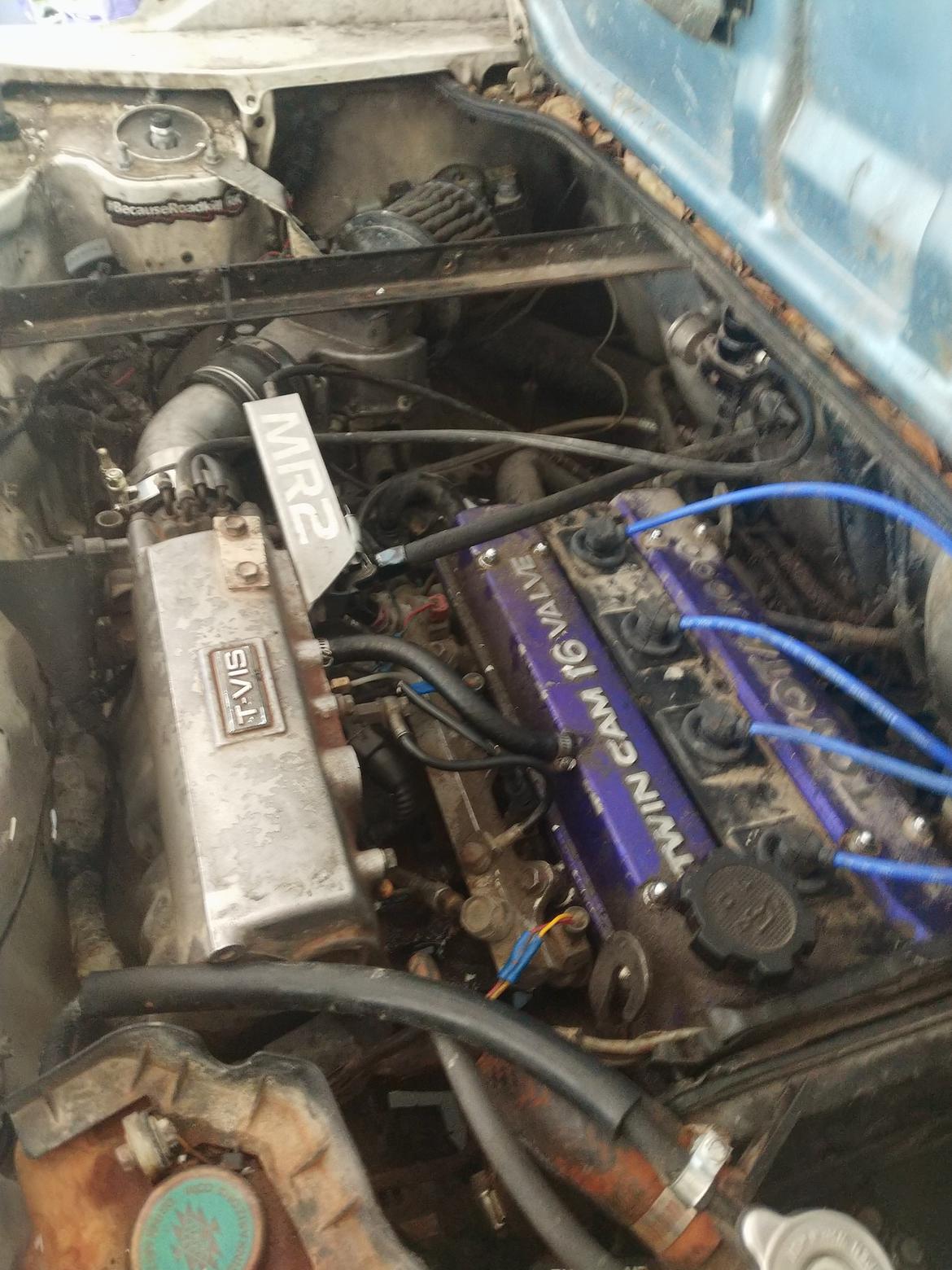

Attempted to put the starter on and found that theres a little nubbin on the block that fouls on a hump on the starter.   Apply grinder to hump and voila it fits.   Yay.
After resolving my hump issue I put the engine in.   I used the MR2 community prescribed method of lifting the ass and then sliding it in.   I made a video about it.
Engine is in a looking not too awful.   This weekend should see all the various bits and bobs connected that make it work.

Got some time on this here Labor Day to get under the MR2 again.   I had a nasty coolant leak at the waterpump which ended up being a pinched o-ring between the water pump and the engine.   My injectors started leaking I bought a bunch of o-rings for both the Dodge they came out of and the 4age they are now in.   Eventually I found a setup that works without spraying fuel all over my intake.
Even though the first time the car ran great after pulling the timing belt to fix the water pump the car was running really badly.   It turns out my cam setup works but is finicky.   Because of the different timing I now sit right on a lobe on the intake cam when it comes time to tighten the belt.   The first time it fell the right way the 2nd time it was a tooth off.  I eventually got it in the right place.    Finally my exhaust was hitting the oil pan so I had to grind a bit of the lip of the pan and bash in a bit of the exhaust.
She is now back on the road and running pretty well.   The response is killer.   I cannot believe the difference .2l makes for it.
