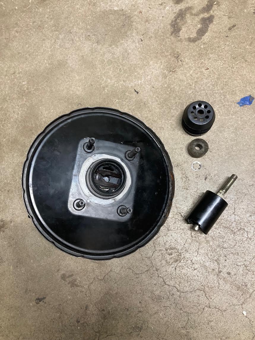

So... some of you may have read my brake booster adjustment thread: HERE. Long story short, I tried to take my single diaphragm miata brake booster apart incorrectly resulting in a broken booster:
So... this presents an opportunity to play with one of the 7" dual diaphragm boosters from fleabay. After receiving the unit, it is clearly low quality. However you may remember that firewall space in this car is extremely limited, making the tiny booster an attractive option if I can make it work. More updates to come, as I have a track day in a week and a half.

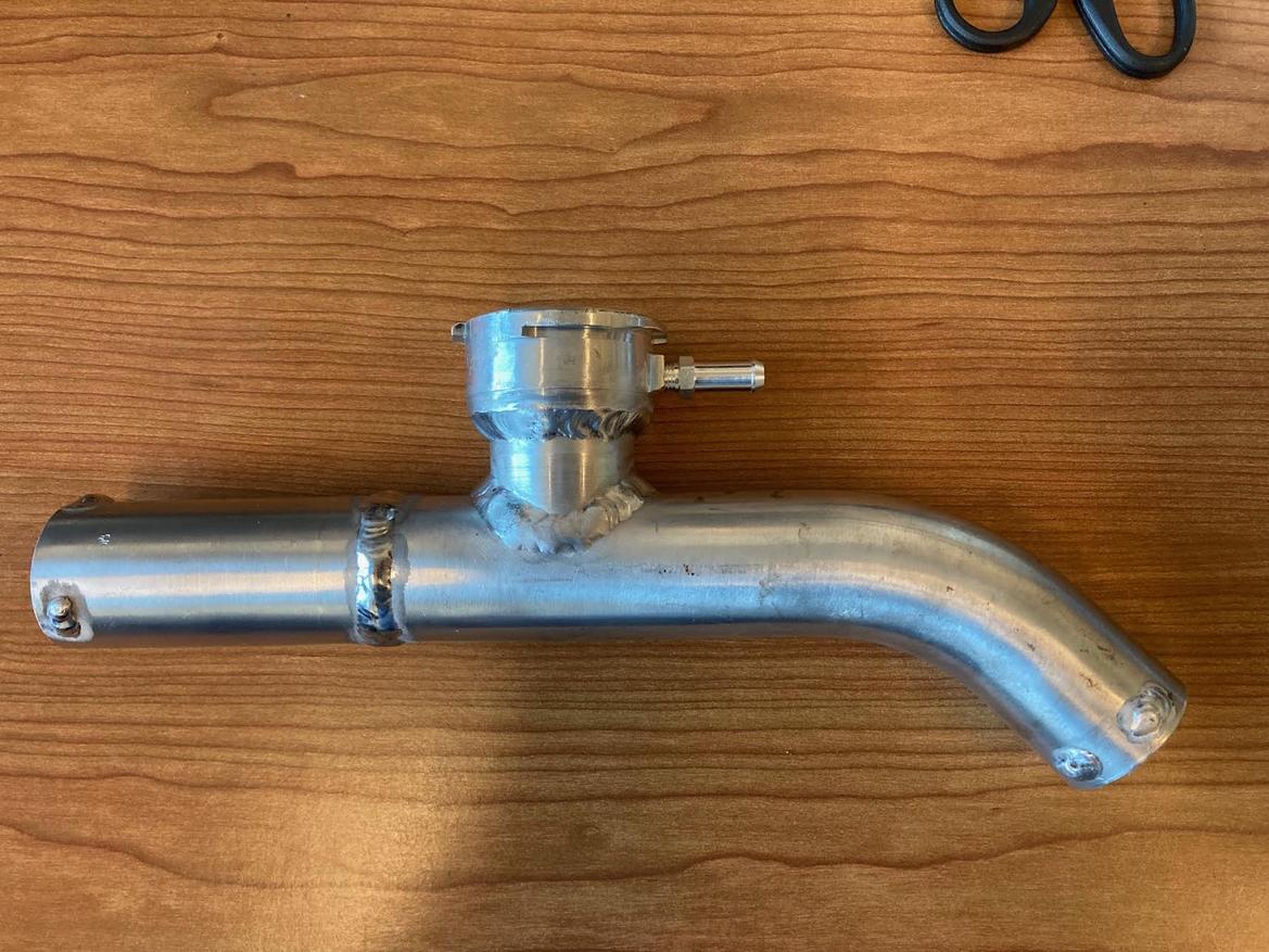

Next up a couple of cooling system modifications. I replaced the high pressure, but still vented, cap with a solid cap. Then replaced the capped overflow nipple with a plug.
I had been running tap water as coolant at some point in the past, so my remote radiator cap neck was corroded. I suspected that the cap was no longer sealing well. So, after an order to ebay for a cheap radiator cap bung, and a bit of machining we had most of the pieces:
This cleans things up nicely around the front of the engine. It also gets the vent up higher, and more level than it was before.

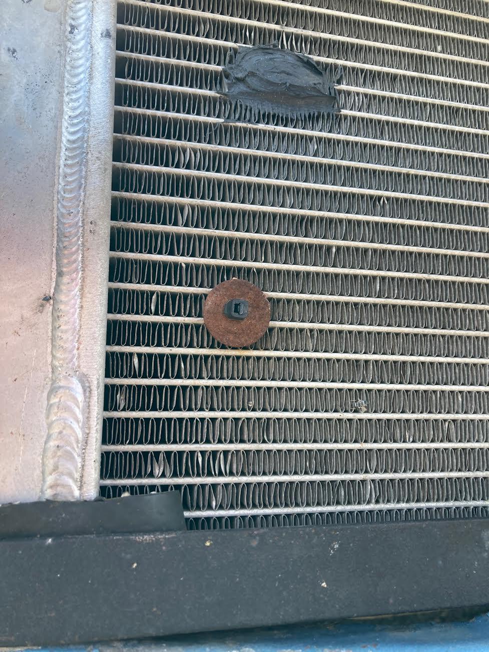

Fantastic weekend spent at the track with my brother. Day 1 we had no hiccups, just fine tuning tire pressures and shock settings to minimize understeer. Day 2 started with a good fast session, however when preparing for session 2, we discovered a pinhole leak in the radiator. This was caused by the bumper filler trim rubbing on one of the tubes.
So we removed the bumper filler and the fins near the leak, then crimped the tube around the hole.
Then we washed the area to remove the coolant, thoroughly dried it, and packed in some right stuff rtv:
I had low expectations for our fix, but it held so nicely that we ran for the rest of the day without issues.
