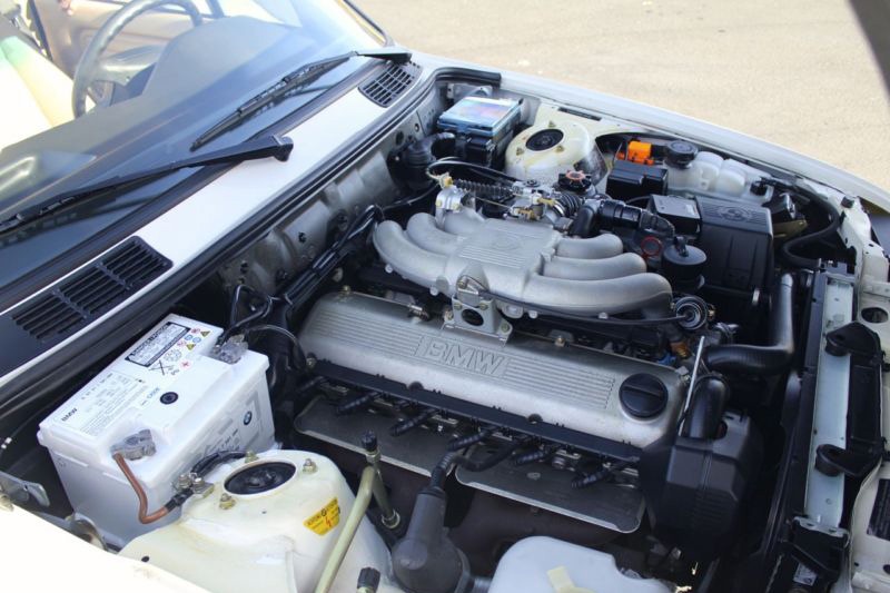

You could get some of that thermal tape to see how hot it actually gets there, or use a thermocouple in a multimeter to get an idea of how hot it gets. Some cars are pretty hot up along the hoodline, and others are not - kind of depends on how well the cowl is sealed and what kind of airflow there is.
Factory battery location is in the position you propose in my E30 for convertible and some other global models. No heat shielding on that.
