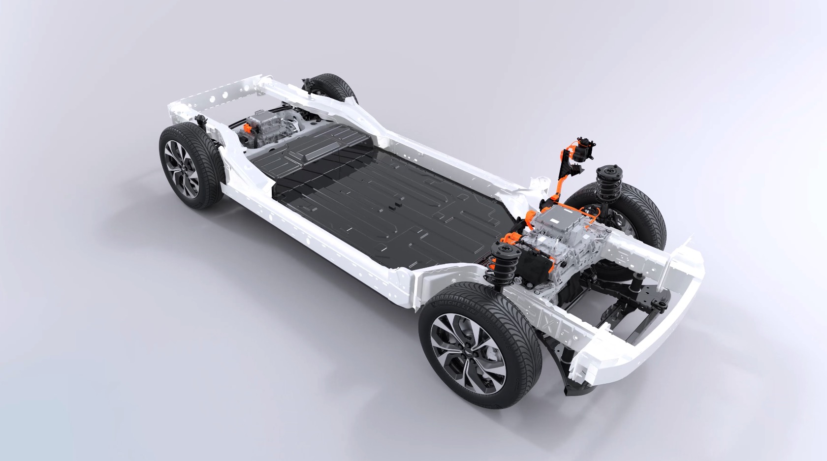

Having the batteries extend beyond the axles would add some packaging difficulties, so you'd probably have room to sling an underfloor cubby under the cargo bay. I know our car has a fairly deep "basement" under the load floor. You also get the possiblity of a frunk.
Here's what a nekkid Mach E looks like, you can see that anything behind the rear wheels is sheer bonus space - I expect the front has at least some minimal cooling/pumps/other hardware competing for that space. That hump of extra battery in the back could be put under the front seats, possibly. Seeing the various designs come out of the OEs will be interesting, as I rate minivans and full size pickups as the two types of vehicles the US automakers are truly good at.

The Mach-E looks like a good starting platform, although I think the front axle line needs to move forward 6-12 inches, which would result in more interior space.
