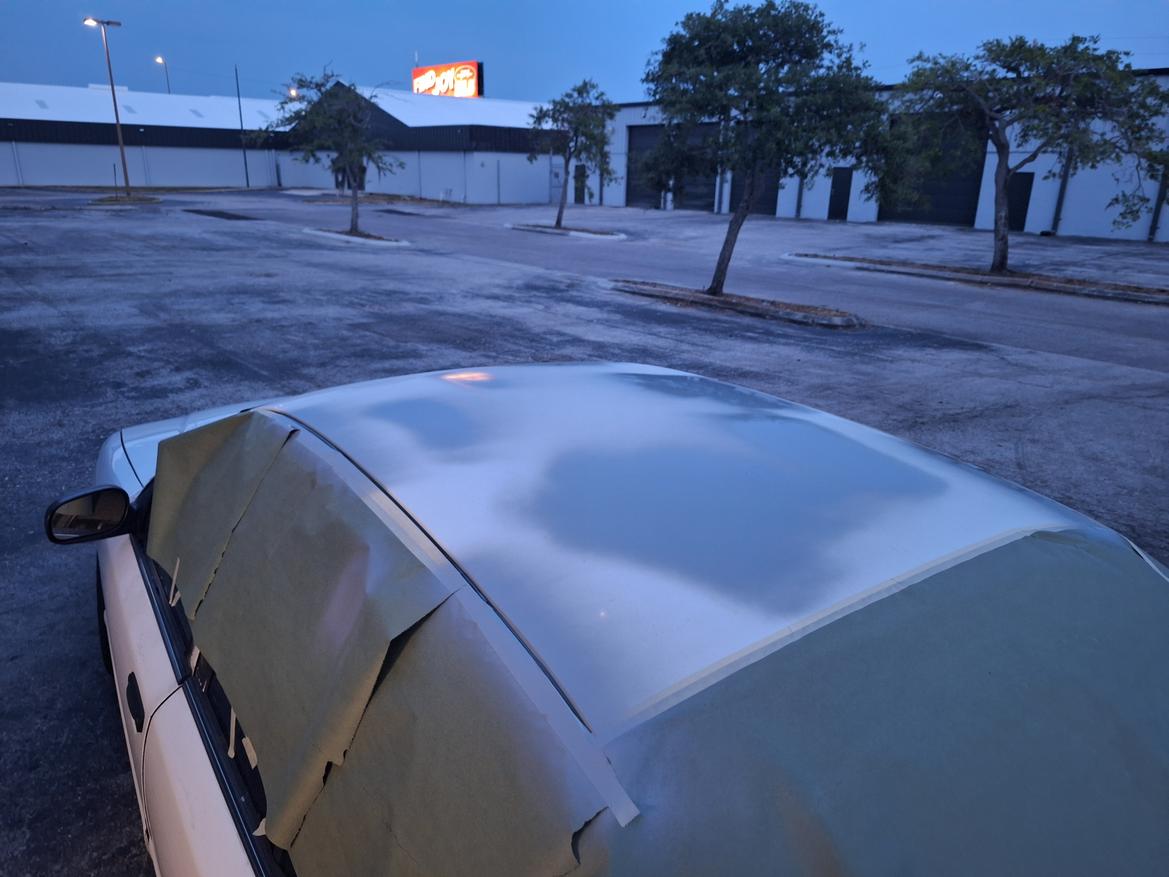

Paint:
Thanks again to John, I'm workin through the painting of the roof.  Over the course of the past three nights we went from a 50ft'er to probably a 30ft'er.  Hopefully I'll have some time soon to get to a 10ft'er
Dropped the headliner, put in some 2x2" plates with some panel bond.  Used rare earth magnets to hold 'em in place.  Cured it, ground it down, ospho, came back the next night.
Bondoooo.
Its strange how sense memory will get you.  I learned wrenching from Chuck and his shop always smelled of curing bondo.  He never did any bodywork that I ever saw, but it always smelled like curing bondo.  Applying it I got sent back 20+ years.  It was... intense.
Tonight was prep and prime.  Got in there and prepped the surface, shot it with epoxy primer.
Now, need to figure out when I can get back in there outside of moving
