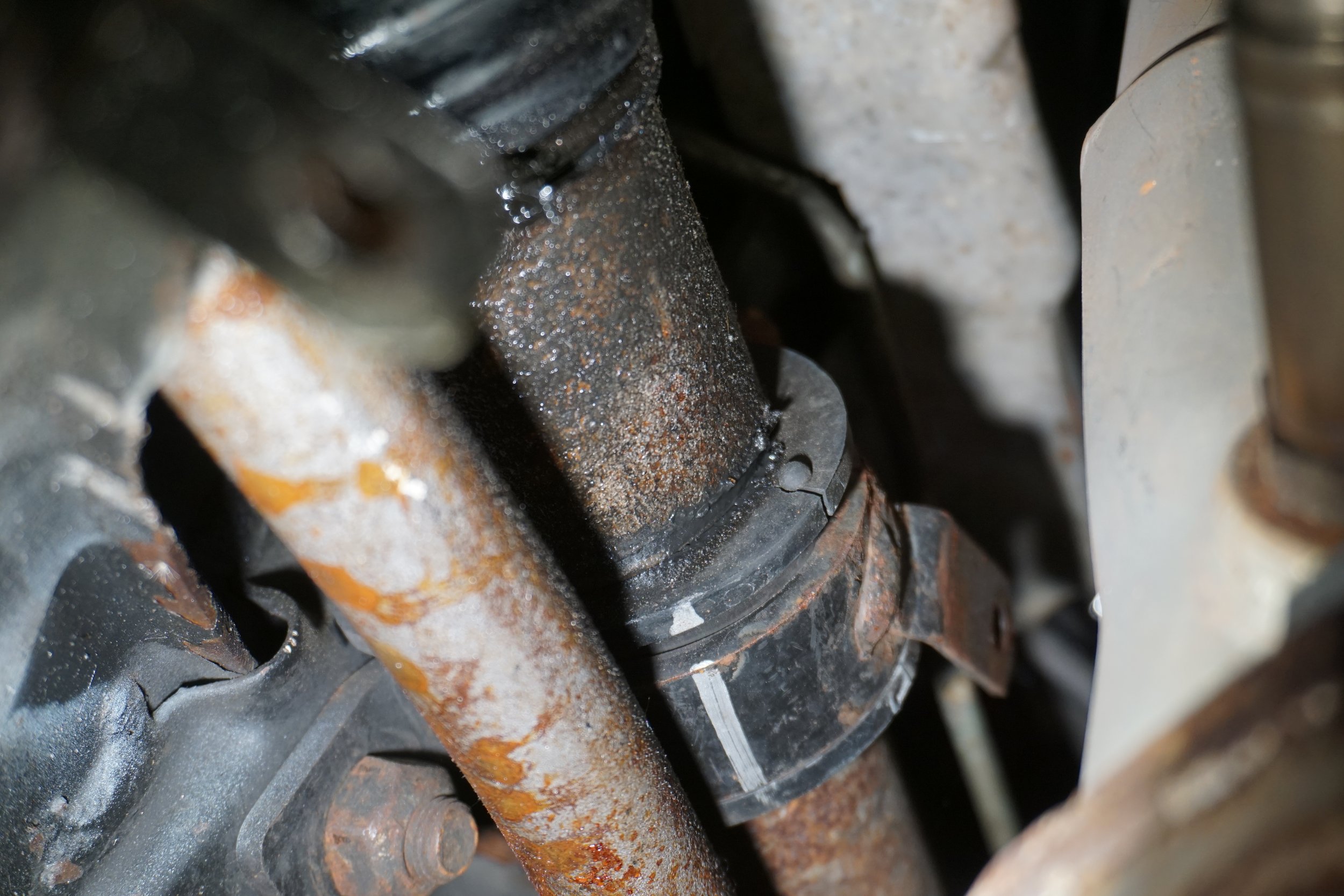

This pic shows what I believe is evidence of it shifting side to side.  Note the clean/smooth section right next to the mount.

The bushing in the second picture is the one that is locating the rack side to side.  I've  gone with delrin is cases like this but I bet you can find a urethane set that is close enough and sand it to fit.

I'd try new OEM bushings first. As mentioned, the "other" mount is the locator and you can see the bushing is worn and locating groove is wider than the metal strap/clamp. (Probably by an identical width as the clean spot on the other side.)
Worth noting though. Most rubber mounts/bushings are not compatible with oil/grease, and some combination seems present on the rack and likely contributed to their failure. It would be worth remediating any potential leaks first to preserve the life of the new bushings.
