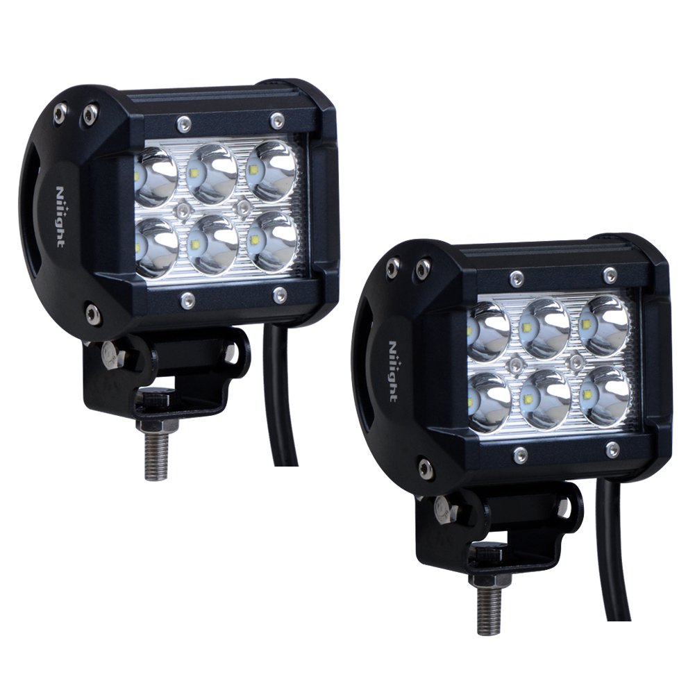

I have a set of these on the front of the Samurai.
They put out a good bit of light, but are not very directional. More of a flood pattern. They work well as a off road light and are built like tanks with all aluminum housings. They replaced a set of Hella lights that the alternator couldn't keep up with.
Linky
