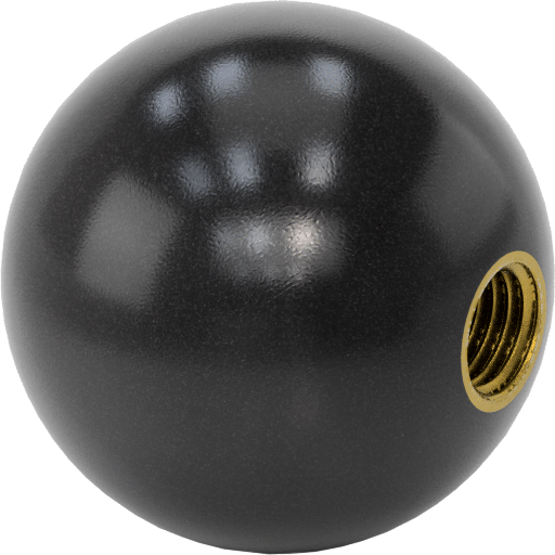

8/6/24 6:36 p.m.
And this 2" knob is $9.47 from Grainger.  But no pattern on top.
2" implement knob
Maybe.  Just maybe.

Up to two inch diameter black phenolic knobs, $4 and under
https://www.mcmaster.com/products/knobs/ball-knobs~/material~plastic-1/color~black-1/
8/7/24 11:29 a.m.
FYI, the thread is 10X1.25mm. All the McMaster ones use the coarse 10x1.5mm. You might have to get an untapped one or do some sort of finangling. McMaster does sell an M10x1.25 to M8x1.25 threaded adapter if you want a taller shifter.https://www.mcmaster.com/92499A827/

You can run a 10x1.25 tap in a 10x1.5 hole and end up with a double threaded hole.
I wouldn't trust it to hold a wheel on or something, but 10-15 years of experience suggests that it works just fine for a shift knob.
