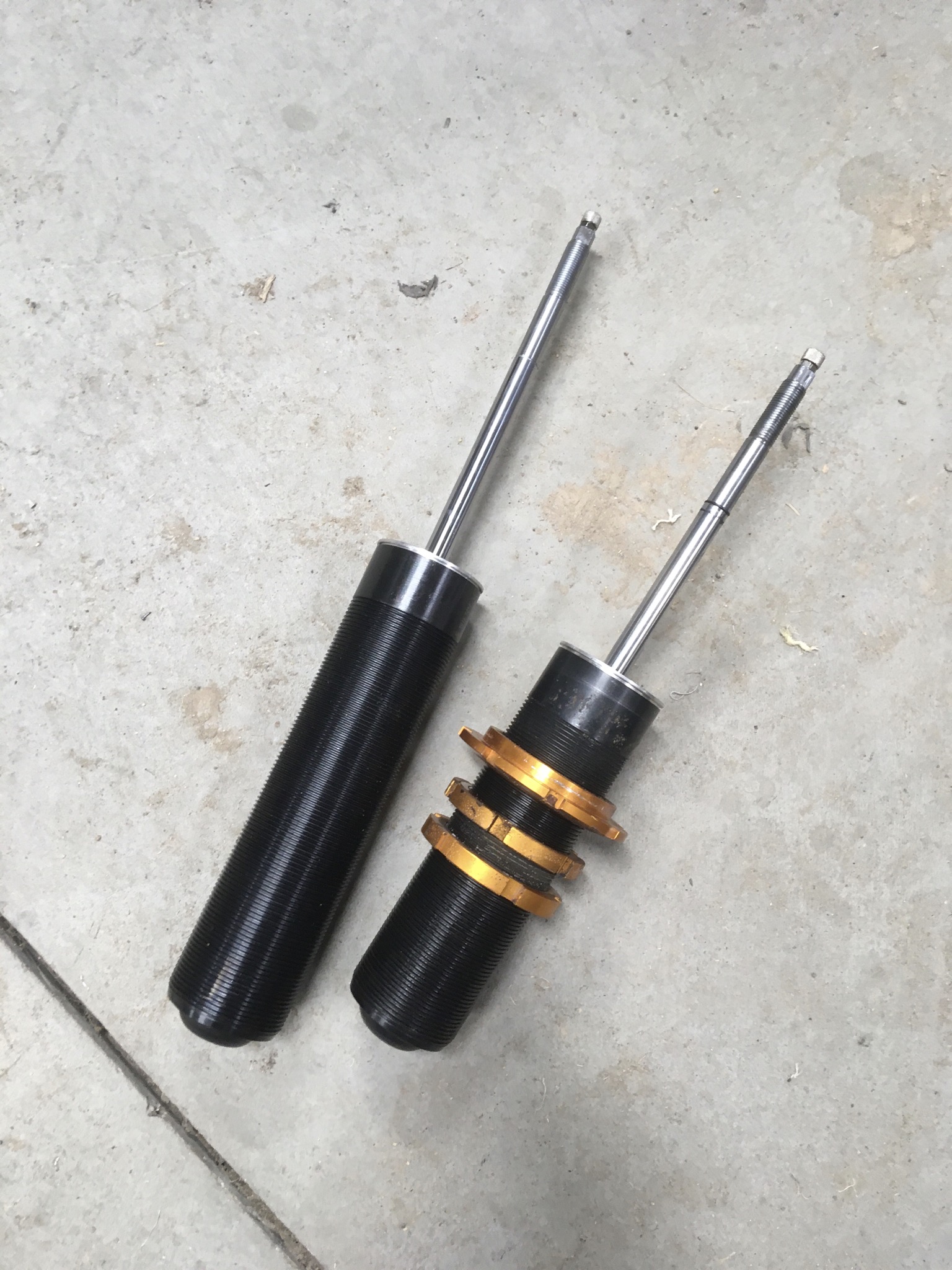

I pulled the bad shock out to replace it. And the replacement is the wrong one. That's it, I'm done.

Welllll.....at least we know they manufacture at least two different inserts.

Tessie at Max was very apologetic about the incorrect shock being shipping - she's asked me for part number information off the shipping box so she can confirm that the US warehouse did ship the wrong part, as she did request the correct one - but unfortunately the box had already gone to the recycling depot before I discovered the problem.
I would like to reiterate that I was impressed with the machining quality on the parts. It was much better than other shocks I've seen in this price range. But it doesn't matter how good the machining is if the design isn't there.
I did try to open the bad shock insert to take a look at the internals, but I wasn't able to crack it open with the tools I had handy. I think a pin wrench with fairly big pins and a nice long handle is needed here. I may have an old bike bottom bracket tool that could work, now that I think about it.
