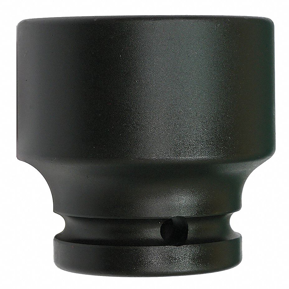

I made bellmouths by using large sockets as arbours in a press. I would just use a long tube, make the mouth and cut to length. Then do as many as you need.
This is the approx profile that worked OK
https://static.grainger.com/rp/s/is/image/Grainger/21WK73_AS01?$mdmain$

That's a clever way to do it...any pictures of the final result out of curiosity? I could use scraps of tubing for that method.(Not that I have a press, but with aluminum being as soft as it is, I could probably come up with something...or just buy one...its another tool I find myself in need of often enough.)
