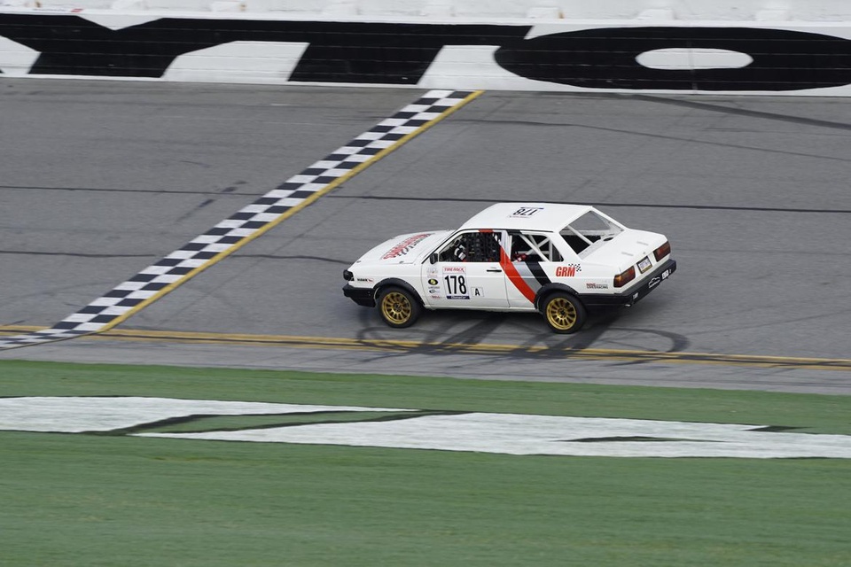

Let's talk about failure. It’s inevitable in endurance racing. Whether your trailer has GRM or Roush on its side, you’ll experience it eventually.
And, well, we experienced failure racing our Fox with the TireRack.com ChampCar Endurance Series at Daytona International Speedway duri…
