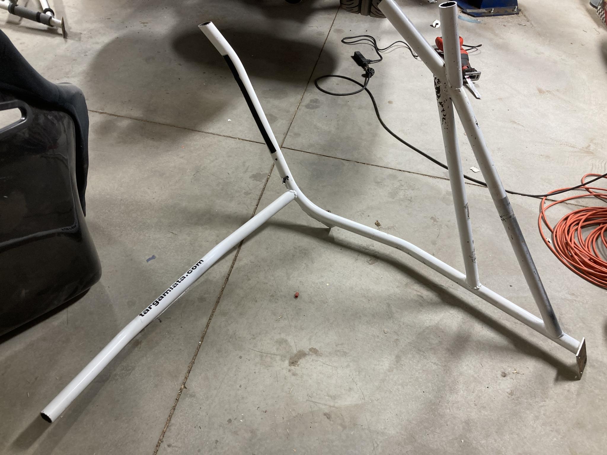

It's always been road legal though all this. Rally car, right? What if I tried turning an experienced and patinaed race car into a street car for a while? This was probably done with various megadollar Ferraris when they were just uncompetitive race cars 60 years ago. The first step is the same, cut out the front half of the cage.

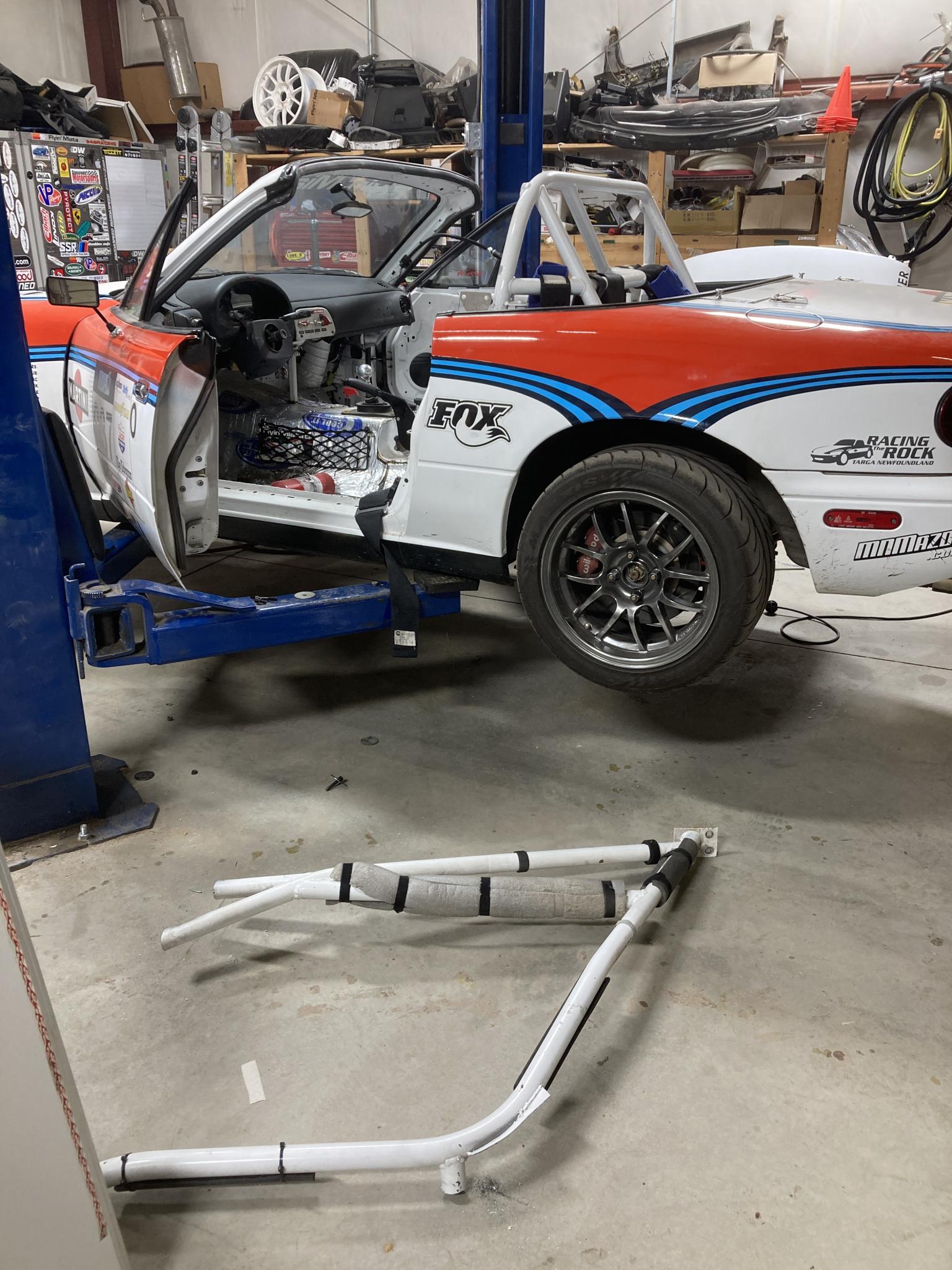

So that's what I did. This is what happens when I go into the shop and feel like doing something fun.
Gulp. That's a real statement of intent. I've never actually driven this car without a full cage and this is the first time it's not a weekend away from being capable of rolling up to the start line of the Targa Newfoundland. After the sawzall surgery, I ground off the stubs from the main hoop so I can either add padding (not really an issue with my seats) or simply make it look less like someone sawzalled a cage out of the car.
Also - the front brake hoses are removed. The big 3" diameter ones I use rub at any real lock and the hoses were pretty haggard anyhow. I mounted a set of 200 TW street tires in a 245/40-15 size because, well, because. The brake pads have been swapped out for a street-friendly compound. Ride height is raised up to a street-friendly number and the front airdam, spats, engine skid plan and flat undertray are gone. The skid plate was damaged, that's why it came off. I also pulled the wing off, although that's a 3 minute job to replace. I've pulled the harnesses so I can replace them with newer ones.
So that's step 1 of the Targa Stradale. So far, all the changes are ones I'd be doing if I were updating the cage for hard-core track use or are simple bolt-ons. But the next step will divert a little further.

As someone who did the exact same thing to a much less powerful miata, you might want to have a frame rail and butterfly brace "disapear" from work and appear on your car ;) Amazing how much turn in/rigidity was immediately lost on my car from caged to rollbar only.
Looks like it'll be fun!
#BecauseStreetCar

The car is seam welded and has frame rails along with a crossmember that holds up the T56 trans. I could see the windshield header moving as I sawzalled, though - I did consider adding a single bar that goes from the center of the rear hoop to the center of the windshield frame to bring some of that back.
