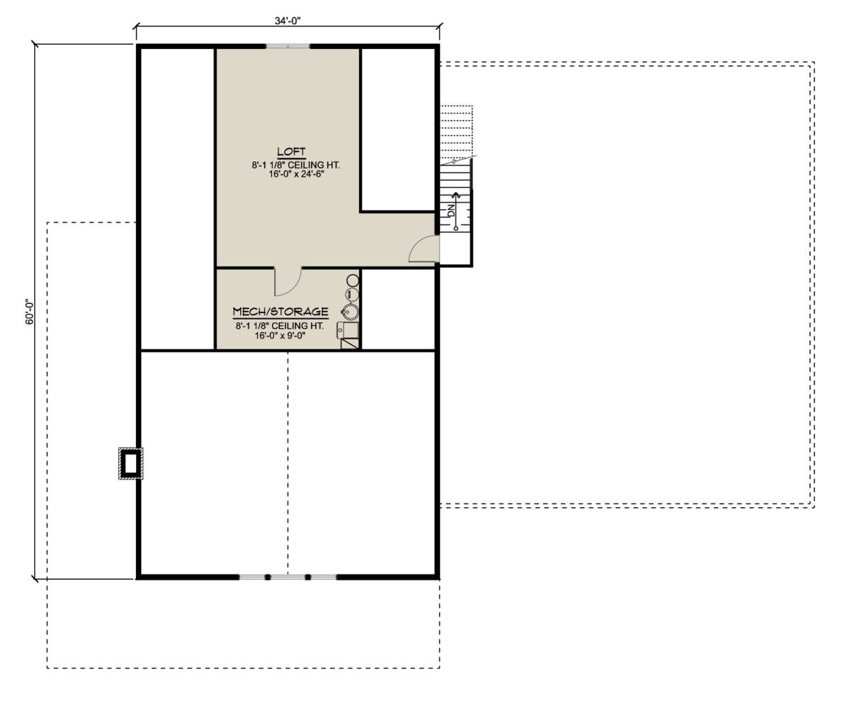

Quick note while we are waiting for VolvoHeritic's meds to wear off..:
That Great Room doesn't have 11' high walls. It has a pitched ceiling which is 11' high in the middle. The walls are 9', just like the adjacent BR walls.

I don't see a loft. I think that is attic access.
The dotted lines in the great room indicate a cathedral ceiling. The exterior elevation on the left side shows the wall height equal to the BR behind it.
The gable wall IS taller. It's a gable. Scissor trusses in the great room- ceiling is a lower pitch than the roof. It clears the eyebrow window, then peaks at 11'.
Pretty sure no 11' walls.

Ok, you're probably right. smiley We need an elevation view and maybe a section. Stairs are to the optional basement?

In reply to VolvoHeretic :
Haha!
I thought of that, but they are clearly labeled "Up"

The stairs are to a bonus room/loft over the bedrooms. I didn't provide that part of the plans. There is also a basement option for those that don't live where the water table is 24" down.
Loft for House Plan #5032-00151
