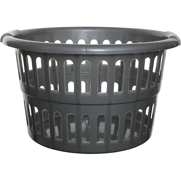

1. Do you have a battery back up on your current sump pump?  I suspect you are more likely to experience flooding from power failure than you are to experience flooding from pump failure.  Heavy rain and wind event knocks down a tree somewhere and you dont have power for a day...basement fills up.
2. Another option for backup pump is to stack the pumps.  Here is a well documented sample: https://www.instructables.com/Keep-your-basement-dry-with-stacked-sump-pumps/  They build a structure:
I might consider less structure of making sort of a 3 leg table out of 3 metal legs and like a small Weber charcoal grill grate as the table top.
Or, turn a wire trash basket upside down as the whole structure.
Metal might rust.  If you can find one strong enough, an inverted plastic laundry basket:
