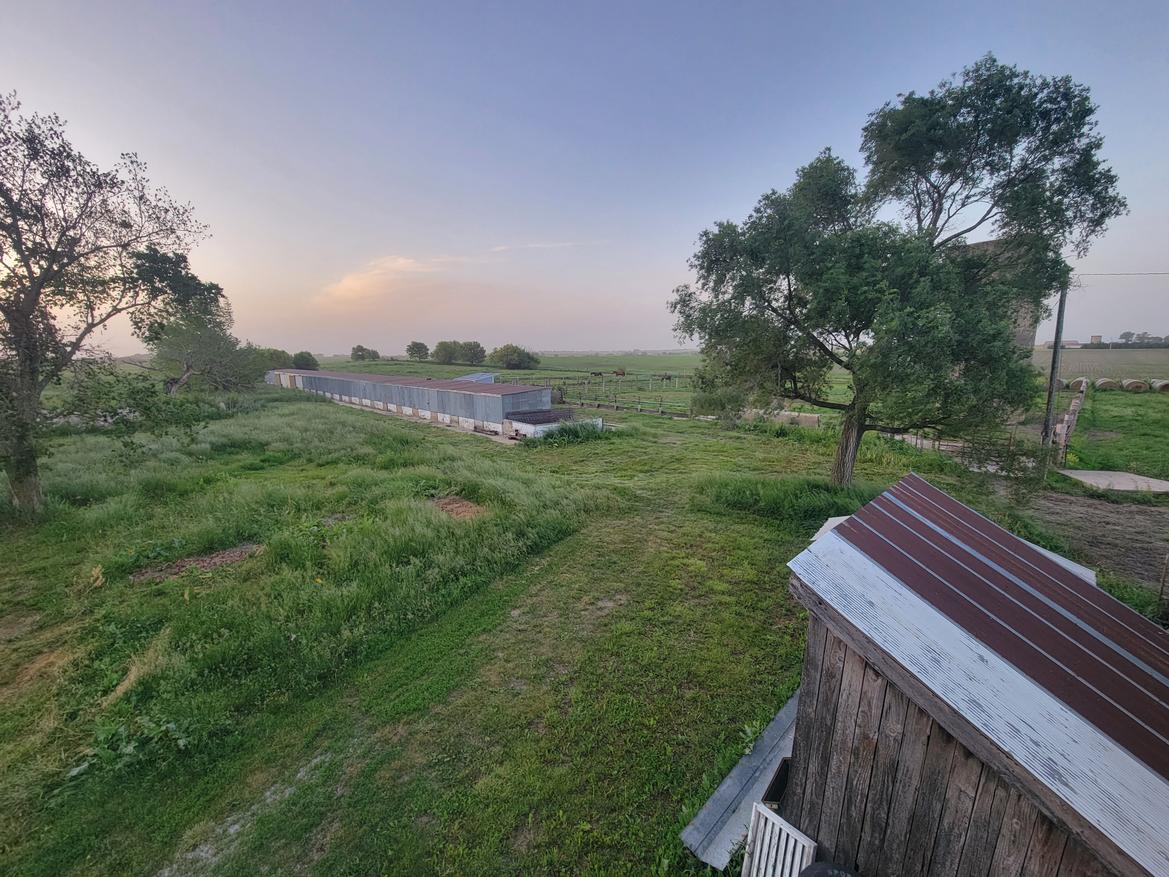

So I'm brainstorming a shop. Right now, thinking a 40x60 metal building with a 20x60 lean-to on the south side. 60x60 concrete under the lot. Three garage doors on the south, with a lift lined up on the eastern door. Southwest corner reserved for the South Bend lathe, Wells Index mill, air compressor, welder, drill press, tube bender, and a nice big frame jig table. Nothwest corner set up for "bathroom", or at the very least a good shop sink. Couple of strategically placed overhead drops for air and electricity. Ideally an overhead i-beam or gantry for a chain hoist. Ventilation for the welder specifically, and for the shop at large.
We're in rural Kansas. Neither of us grew up with real high heat in the winter or real cold AC in the summer; just want the space to not be at the extremes. Thinking spray foam insulation. Maybe geothermal for in-concrete heat, although a coworker suggested a wood-fired boiler. Possibly radiant heat down the peak for a little additional heat in the coldest times. Good quality concrete. Likely use the digging for the concrete forms as an excuse to make sure there's good drainage away from the building.
Please use this space to be good idea fairies, to tell me what I'm overlooking, or to make suggestions. I'll post more as things solidify.

Driveway approach from north to south on the west side of the building, with gravel turnaround south of the lean-to.
There is never enough storage, but the intent is to put the other farm buildings to better use as storage and keep the shop as usable work space and storage for the projects that live in the short and long-term spots (wishful thinking, I know).
