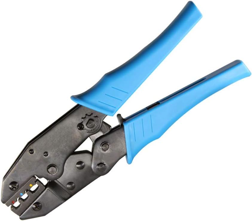

Do you have any reccomendations on a decent "hobbyist" crimping tool? Is it worth getting a quality ratcheting crimping tool with swappable dies?
5/28/20 8:51 a.m.
There are a whole bunch of ones that look exactly like this and that sell for about $20. I've been using one like it for years. I forget the brand name of mine, it's more Western and less Chinese - I'll check later today.  Mine has swappable dies but almost all my crimps are done on the same type of connector so I rarely take advantage of that feature.

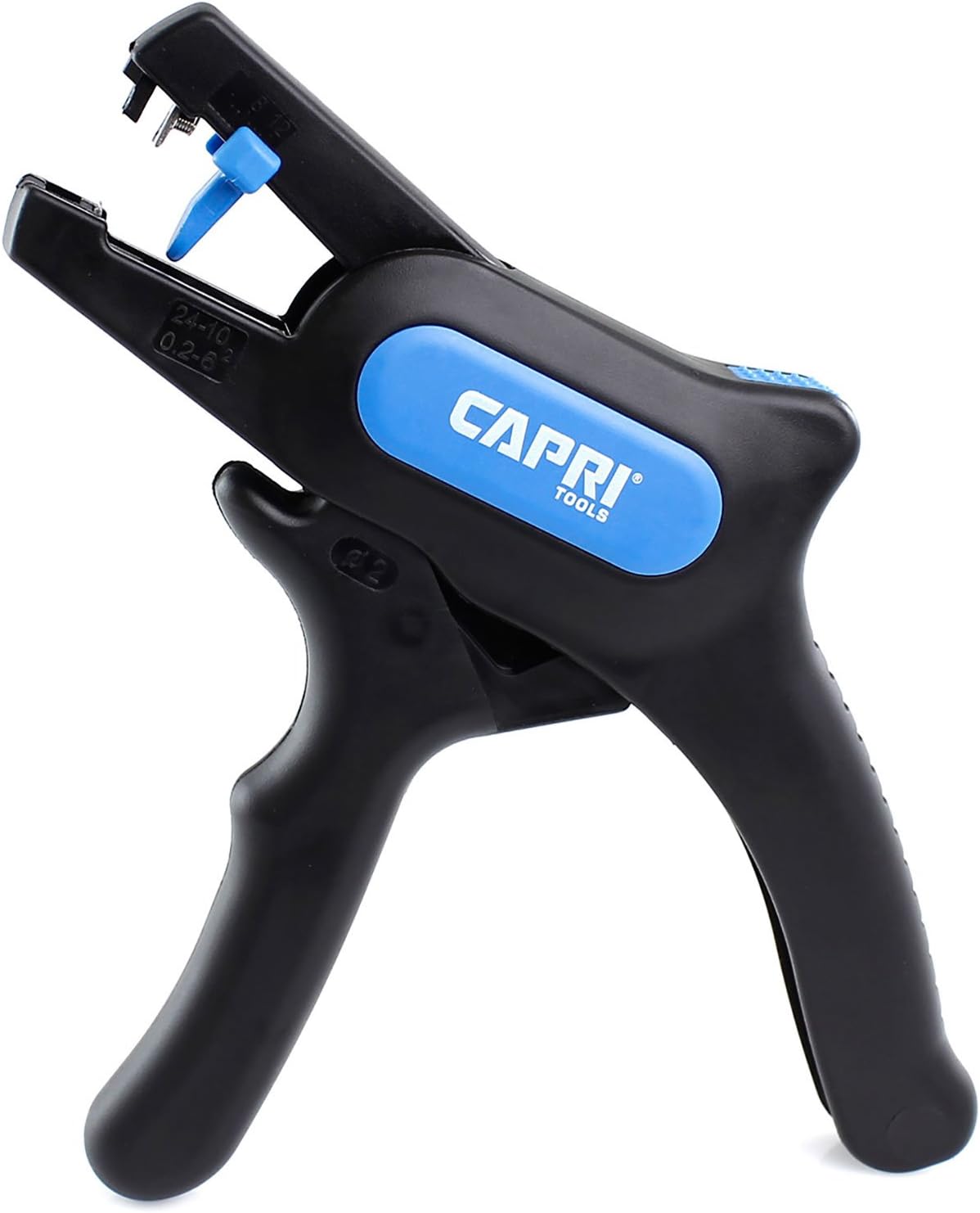

So do you guys use one of the plier-style automatic wire strippers? Seems like they'd be hard to get into tight spaces when working ON the car.

I use one of these on most of my car work. It needs about the same space and uses the same approach angle as the crimpers - so if you can't strip a wire with it, you're not going to be able to crimp it!
This is a similar style, but it doesn't auto-adjust for wire gauge so it's possible to accidentally turn a big wire into a little wire especially in tight situations. I think they're a little more reliable, the adjusting ones need regular lubrication to get just the right tension.

BTW, my crimper is a Tool Aid like this one. I can vouch for long term quality although I think there's a New And Improved version.
