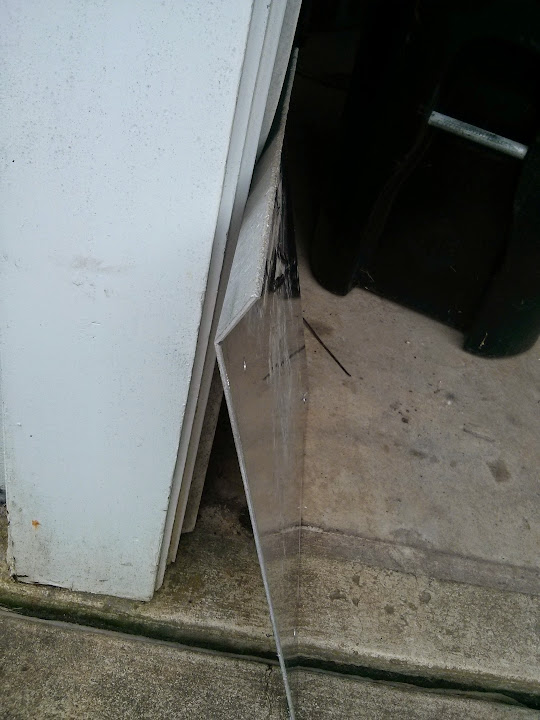

Needed a skid plate for the RallyX miata. Measured and laid out the template in CAD. Transferred to 3/16 aluminum. Installed under car.
It was just a flat plate for the first RallyX since my friend did not have time to bend a front lip on it yet.
It picked up a bit of gravel in that first event.
Yeah it pretty much acted like a giant scoop and picked up lots of gravel.
