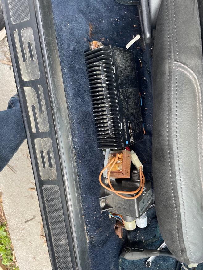

The 928 is almost completely original, including the tape deck. It didn't work, and that bummed me. I like tapes. I have a lot of good memories jamming ...And Justice for All on cassette in high school. So I got a new tape deck and put it in.
It was a bit of a pain to get to in order to install, but overall went well. I turned on my car and...nothing. A slight crackle from the driver's side rear speaker and nothing else. Damn. Mine came with the factory amp, so today I replaced that.
Sorry for the sideways picture. Anyways, after hooking up the brand new amp, I turned the car on and...nothing. A bit more crackling. I still need to go through all the fuses and sort out the electronics on this beast, which will take a while. But let's shift gears a bit.

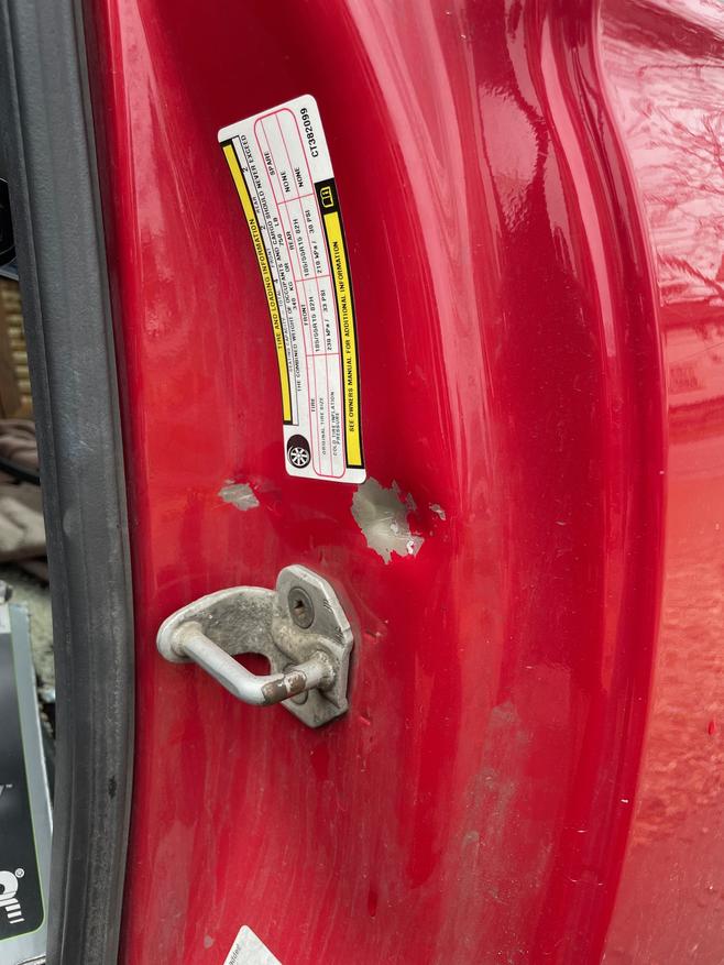

So my fiance owns a house in a E36 M3ty part of town, because it's cheap. She's renting it to some friends now, as she's moving in with me. She went over to get some things the other night, hears a pop pop pop as she's walking to her car! A bullet struck about 3 feet away from her, right in the door.
Honestly the damage isn't that bad and it affects nothing. Buuuuuuut, these stories are never easy, right? So after the bullet exited the door, it dented the chassis inside the door.
And that's the problem. Repairing that is expensive, and this is an 11-year-old Fiat 500. It's not worth much. So, this was enough to total the car. We're in the process of buying it back right now, actually. It'll have a salvage title but eh, big deal. It's just going to be a fun car. I've almost convinced her to turn it into a 2000-challenge car, using the buyback cost as the price of the car (because it will be transferred into my name, so I'm essentially buying it for that price). So, if anyone has any good Fiat 500 parts, lemme know!
