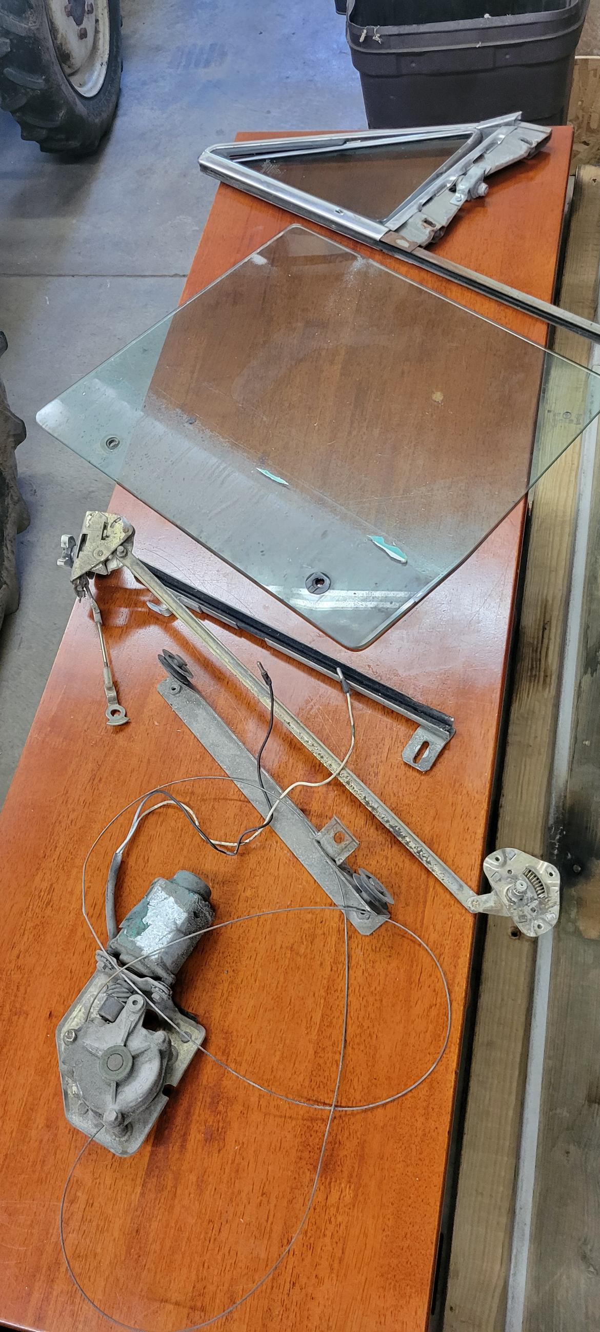

Made a little more progress today, with some help from Ice Cube on Spotify. Got the door internals disassembled, so the windows, frames, motors, and lock/latch mechanisms can get freshened up at the house on days I can't come back to work on the chassis. I also pulled the whole dash wiring harness out yesterday: if you have a Spider, I'll be selling it, so please reach out if you want it (I'm in northeast Ohio, but we can talk shipping).
I gotta say, today was a good day.
