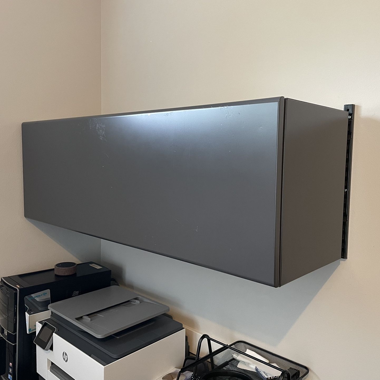

Up here in Furniture city and home of Steelcase, you can find over head cabinets on the side of the road, I dragged home a four piece set a couple years ago. Look for office furniture on FBMP.
