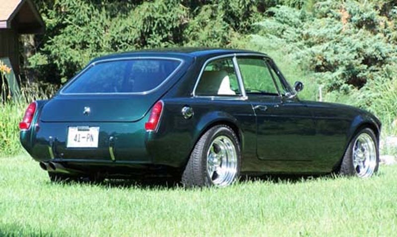

NOHOME wrote: In my humble estimation, this is the pinnacle of MGB GT Build: (Going to guess near 100k went into this one) http://www.britishv8.org/Articles/BV82016-TheCars.htm
Sponsored by Arby's? "We Got the Meats"
